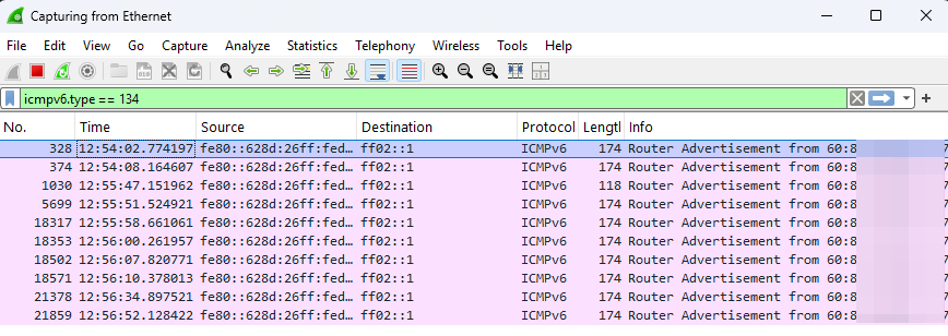

@patters - FWIW, I've just been fiddling with my 7 Plus and I don't seem to be able to replicate what you're seeing so maybe a factory reset will help with things?
Started with a Linux laptop not connected to any network and my 7 Plus powered off.
Checked my wireless NIC did not have any addresses assigned: -

Then for good measure, I repeated a similar test using a wired Windows machine. This one was already associated with the 7 Plus and had valid v6 assignment: -
> ipconfig /all
Ethernet adapter Ethernet:
Connection-specific DNS Suffix . : lan
Description . . . . . . . . . . . : Intel(R) Ethernet Connection (16) I219-LM
IPv6 Address. . . . . . . . . . . : 2a00:[REDACTED]::1e2(Preferred)
Lease Obtained. . . . . . . . . . : 12 August 2026 12:44:26
Lease Expires . . . . . . . . . . : 13 August 2026 12:44:26
IPv6 Address. . . . . . . . . . . : 2a00:[REDACTED]:2a1f:2fe5:100a:44b8(Preferred)
Temporary IPv6 Address. . . . . . : 2a00:[REDACTED]:356a:9d6:50c8:5464(Preferred)
Link-local IPv6 Address . . . . . : fe80::9b7e:6d37:def6:9cbd%15(Preferred)
This time I fired up Wireshark and then restarted the 7 Plus via the Hub Manager.
At the point of restart I saw two RA packets. I then saw a bunch more once the hub restarted and the laptop reconnected: -
And ipconfig looks good: -
