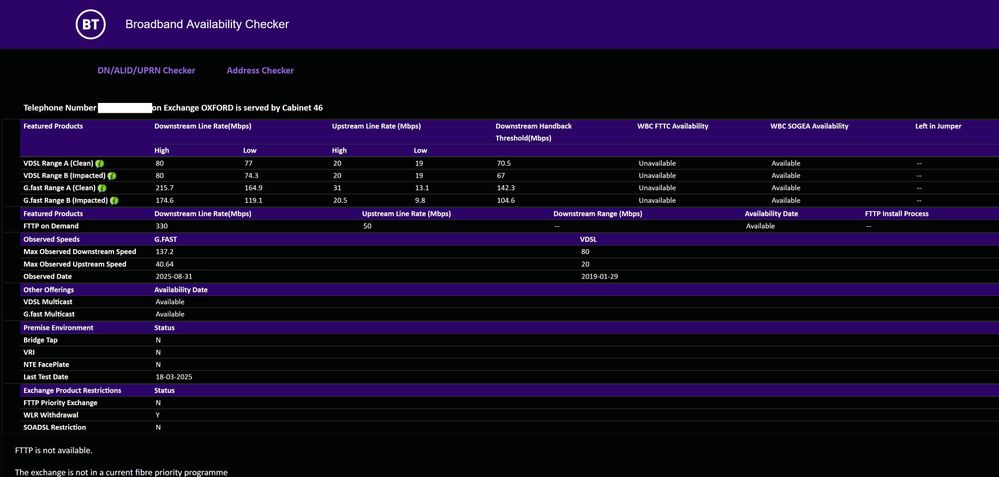

For the fault they're sending a BT engineer as they took the increase in noise and decrease in speeds over 6 weeks to be a clear issue. Fingers crossed its an easy fix! On a good day I'd get 220Mbps judging from the synch logs going back to Jan. I'm not far from the exchange.
FTTP might be coming soon as BT engineers were faffing about with stuff about...oooh about 6 weeks ago I'd say 😉

FTTP is not there yet but see what Openreach Fibre Checker has to say about it.
@dacarlo You must be within the 100M range but pushing up the max closer is way better, and the less on the cable back the easier it is to get the speed up. At 220Mb/s pretty damn good for G.Fast connection!
