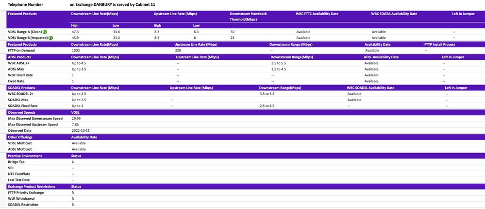

wholesale checkerwholesale checkerRouter statsRouter stats

Not at all. That's an excellent modem-router.
The BT eng was talking thro' his hat when he said you'll get 70/15 Meg. The best you could expect is 47/8 Meg. As it is you are only slightly below the expected range with 30/7.8 Meg., almost certainly the result of your power supply tripping out frequently.
The DLM system has put you on a banded profile in response to these errors on your line, at the top of the up to 30 Meg band of these VDSL Banded Profiles, altho' you now have no significant errors. You need to give the DLM time to relent & remove any banding. If your sync speed at the test socket remains stuck at the same speed for 10 days you should ask EE to investigate the underlying fault, altho' hopefully the new RCD should fix it within that timescale. If a fault is found and fixed then the OR engineer may request a DLM reset. However should significant errors persist the DLM will reapply banding.
