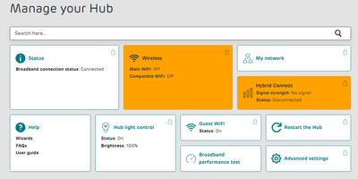

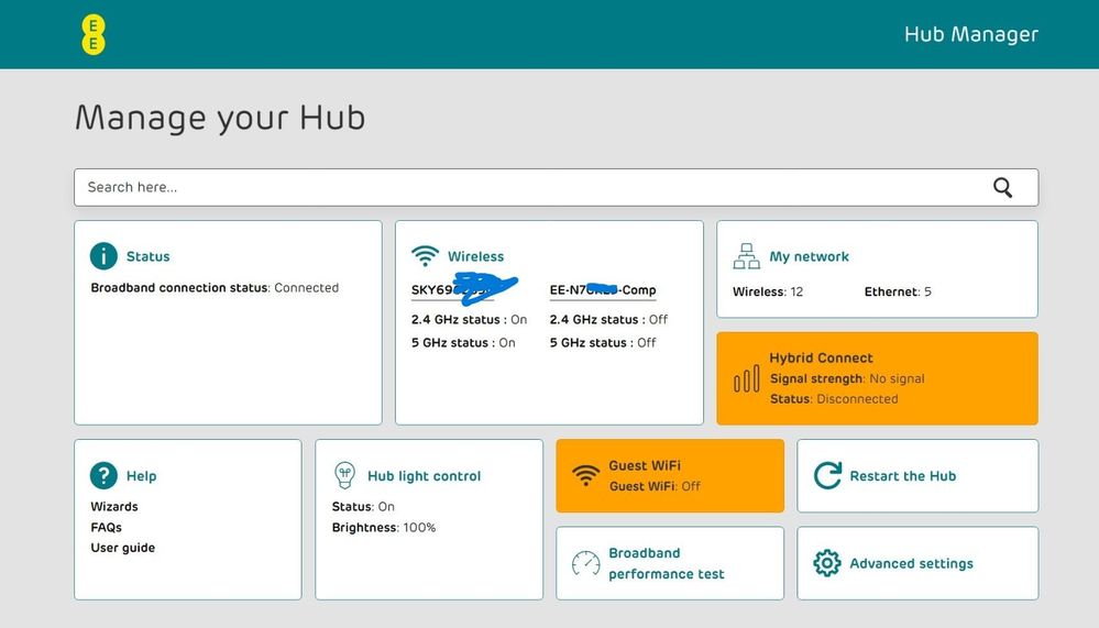

Been having the same issues that many others have had with the extender, also random devices no longer connecting and not seeing the wifi networks/ssid. Thought at first it was the extender, having to re-connect using an ethernet cables, but I have begun to suspect the root cause is the router. If the gui can be believed, it switches off the networks for new connections, existing seem to work fine. Every day or two I have to run the ethernet cable and then power off/on the extender, also I have to use the GUI to switch on the wifi networks...

Your Main wifi off and the Compatible wifi off is a concern from the image you have posted......
Once cleared for viewing but it is an old EE Smart Hub 6 Plus version off the screen and not secured padlock etc.

@sweemy Will take a look at your posted picture if/when it does get cleared for the General Viewing.🤞 The one below is the puppy if you happen to have this version now..... Anything else then something else going on.
Edit:- your picture cleared, up to you now, would be calling EE CS to find out why, as before EE is not saying the if/or why so cannot whole heartedly say yes/no but do not waste any time as other Postings with the Pro are causing all kinds off issues!

Sorry been away for most og July, yes its still happens and seems to be getting worse. Couldn't toggle then on this morning, resorted to power on/off the router. 6 hours later, all the OFF again. Toggle them ON and within 5 mins they are off again...image.png

@sweemy Have you looked to see the latest is now below. Take a look at the other posting by @Gelert5 once i get it linked. His is the 6+ version and the 7 Pro has just dropped if you indeed have it, FW page is updated EE wise so assume it's pushed out everywhere now. Are you using the app to toggle off/on condition for your Pro hub, if so check your version that you are using before doing any update to it also. App updates have NOT been playing well recently.
FW: r4.29.1-R-1930437-PROD-1 and the gui is at App Version 3.14.5 27/07/2026
