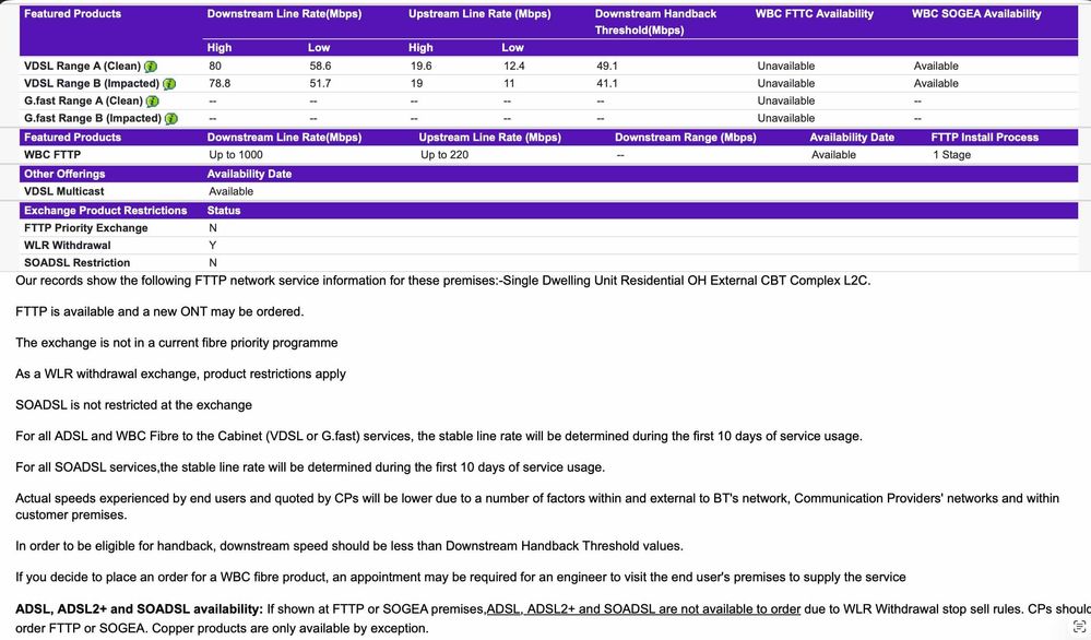

@Scalpaca Use both the OR checker and the BTW checkers below. Address only, house number and postcode should be enough, post the info up but hide details on top like your location.
BT Broadband
Fibre broadband availability checker | Openreach
See the link, this is mine with a FF connection now for the last two years...
Re: Hot and cold messages from EE/openreach is this usual? - The EE Community
@Scalpaca The BTW you did confirms that FF is available although is marked as a complex L2C install currently so it just may not be completed on the OR side of things, and as an OH install. So if you go look currently your copper cable from the pole to the home and if the CBT has been installed top of the pole yet.
As far as EE are concerned with the Database Entry the FF is what you get, so may be difficult to get the FTTC activated from there end if it is FF not available/completed at the OR side....  SOGEA is available for the partial fibre side as it is not indicating sold out, but if the info in the database is all wrong then big stumbling block, ask the Engineer when he arrives if an OR engineer if he knows currently what the street cabinet is like for a FTTC product, with the speed indicated at 80Mb/s you must be right on top off it so it's very close to your home.
All off the OR Fibre is now planned out off India, so only the Fibre Engineers on the ground have any clue what is potentially happening.... The entry WLR Product Restrictions apply does not help you at all, and may stop EE or any other potential ISP getting anything done.
