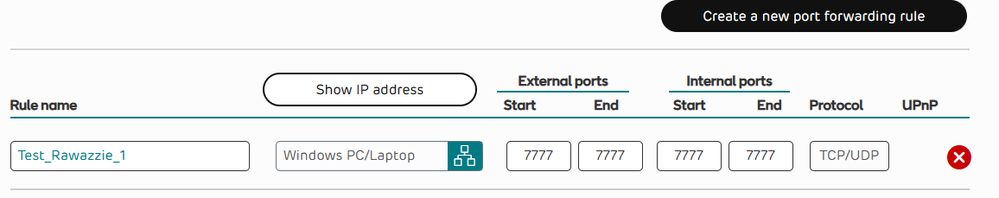

I'm trying to forward port 7777 TCP/UDP to a static IP on my network for a satisfactory server, however the hub simply wont let me do this.
What I have tried without getting the correct result:
  • a single rule using the TCP/UDP protocol
  • two rules one for TCP and one for UDP. only ONE of these is accepted. I cannot add the second rule. (red boxes appear)
  • add a range 7776-7778. both as a single rule and as two separate rules
  • tried using incognito on the browser, adding a rule, saving and then trying to add the 2nd rule from a different session
  • resetting the hub by unplugging it for over 10 minutes and trying all of the above again.
I'm at wits end as to why this hub won't let me do something as simple as forward a port. Any help would be much appreciated.

What is the correct result? As you seem to be messing around with browsers while setting the rule(s), It would seem that the correct result you are trying to achieve concerns the actual setting of the rules.
So this doesnt work, not allowed to add a TCP/UDP rule for this port for some reason.
I created one of the rules first, and then try to add the next one, it also wont work:
side note: I cannot alter or remove that port_map_UDP_65112 rule. I assume it is mandatory somehow?;
Also cannot add it as a range to include the desired port:

I want to forward port 7777 for both TCP and UDP protocols but the UI doesn't seem to permit this port to be forwarded for both protocols simultaniously..
I've been googling the issue and some people claimed to have worked around the issue by using new or incognito sessions for each rule they wanted to add. Sadly this workaround did not work for myself. I listed the things I've already tried to skip the part where anyone willing to help would tell me to try the things I've already tried.

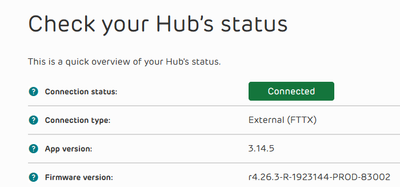

@Rawazzie As you have the SH32B and are now on the latest FW update that has just been pushed out to that version of the EE Hub's within the last few day's or so starting here is the link to what was getting done.... The one you cannot remove is being assigned on a device that is using Universal Plug and Play. That was an issue reported on the newly released 7+ version off the EE hub messing big time with the Port Forwarding rules, just so you are aware.
EE Hub firmware versions - The EE Community
FW: r3.8.30-R-1627300-PROD-83002 and the gui is at App version 3.1.18 05/12/2025
FW: r4.26.1-R-1860948-PROD-83002 and the gui is at App version 3.14.5 25/05/2026 OP Posted Stability Problem
FW: r4.26.3-R-1923144-PROD-83002 and the gui is at App version 3.14.5 12/06/2026 OP Posted
@Rawazzie - I am on the same hub/firmware as you and I have no issue creating a TCP/UDP rule for the mentioned port 🤔:-
However, I do encounter the same issue as you if I try entering them seperately i.e. I create the TCP rule, but the second UDP rule isn't allowed.
