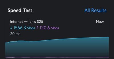

My first speed test:
(Not bad for wifi connection ? )
Anyone saying wifi is slower than ethernet - not always true.
