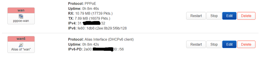

Hi again,
Got connected today. The IPV6 prefix is a /56.
I think people may be conused into thinking its a /64 due to the layout of the EE router pages which are "simplified" to say the least.
Anyway a /56 is fine, thats 256 /64s avaiable on the lan which is more than enough to me.
I have gone back back to using my old OPENWRT router as the user interface of the EE router doesn't allow me to do what I need.
Is a shame they have spoiled a router, which should be very capable according to the specs, with a completly dumbed down user interface!
Here's a screenshot of the wan interface on openwrt router.

Well that is good gives some subnet options. On the EE router is overally simplified even the advanced options you only get to see the allocated LAN interface IPv6 (a /64 no control) nothing other than IPv4 on the WAN side certainly can not change anything not very good
Would be good to change at some time to pfsense to play with as familiar with that on BT business circuits
The catch will be digital voice and if I can put the EE router behind to still support voice
