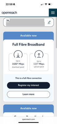

I live in a terraced property and have recently signed up for Essentials 300Mbps, which is the maximum speed currently available to my address.

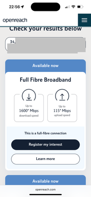

However, I’ve noticed that my neighbour to the right, whose property is served by the same telegraph pole is able to access full fibre speeds of over 1Gbps. This also appears to be the case for the rest of the street. It seems only my property and the one to the left are limited to a maximum of 300Mbps.
I’ve tried to raise this with EE, but I have not got anywhere, is there any way I can force the issue?
Above is my BT wholesale results and below is my neighbours

@JimM11  Exactly however when inputting my neighbour’s house number on EE’s website and others it shows me the full fibre speed of 1.6 Gbps.
the only difference on the tables are that on my property, it shows the “single dwelling unit” as “not evaluated”, and my neighbour’s as “no animated issues”
@charliekrad Check the OR fibre checker for your address.
Fibre Checker
@charliekrad   the table also shows you already have an ONT, and KC12 and so a survey would be required before any confirmed instal.
Until the survey is completed, there may also be a need to update equipment, either the ONT or in the exchange. In the early days of FTTP 330 was the max you could get.
So, do you already have an ONT?
@JimM11  Same results for both.  We are 34. I feel like I have exhausted my options and cannot really get anywhere speaking to EE.

@charliekrad   assuming that was a while ago then.
The Openreach checker always gives the best case, the BTW is what all ISP's use, so until Openreach get a new order and survey the equipment it will stay that way. Any ISP that offers you more than 330 at the moment is taking a risk, but one that should get sorted once the Openreach survey is done.
