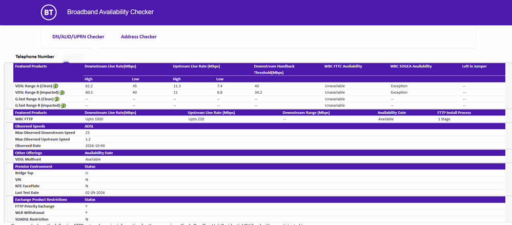

Yes, they turned the BB back on straight away. I'll try to post a screenshot of the BT checker results here:
You are on the lowly ADSL BB, albeit at about the fastest it can go. If you switch ISP you will be offered Full Fibre (FTTP), & only FTTP, at practically any speed you want or even if you upgrade within EE. Even if it's a bit more expensive it will be far more reliable & faster than your current ADSL BB.

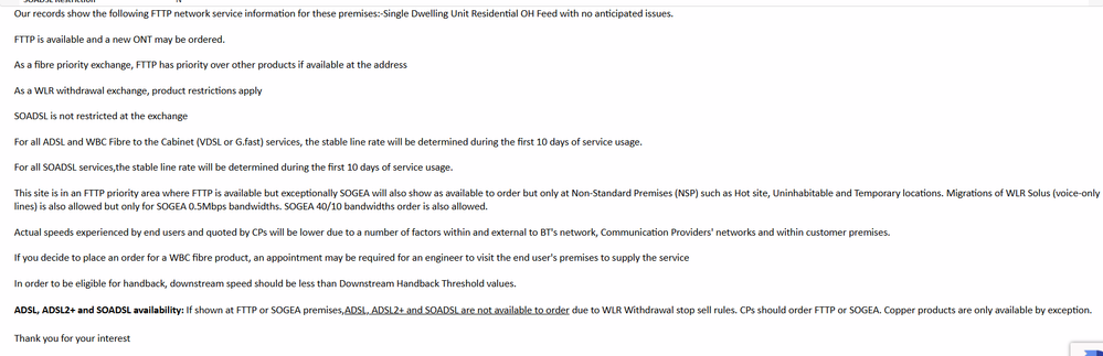

As your issue involves your address rather than your phone number would you run the BTw Checker again but this time using the Address Checker to see if that has any trouble with it.
@NewUser54321 At least you would seem to have a quick Installation for the FF connection and all done on the one day, link below as @XRaySpeX and use your building Number plus the Postcode to see if it throws up the same table for you. You can just reply yes/no as you have already posted what your connection is like. Best to get it all done now before they cut your Broadband off 31st Jan 2027 and put you on Emergency Landline Phone only. Quick U switch has EE FF150 at £24 as a new user for me but as you say no cash back offer on it BT has same price £90 reward but not sure if they will allow you to move between as already a BT Group Cust,

I have run the BT checker again using the house number and postcode alone, and I can confirm the same results do come back.
