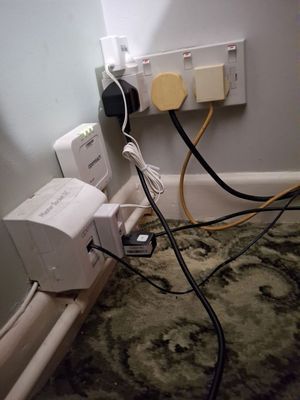

If you've got Full Fibre you won't be plugging your router into a BT master phone socket but into an ONT modem fixed to the inside of an external wall. Didn't you have 1 installed? It would look like the square box nearest the mains sockets assembly in :
(Ignore my master phone socket closest; I have it for other reasons).
If you have Full Fibre your landline should be digital & any phones should be plugged into back of router or an analogue adapter. In which case the BT master phone socket is not used & should be dead.

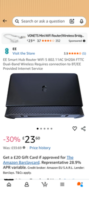

The top one is the new one, where as the old style bizarrely seems to work without any glitches, albeit at slower speeds. Where i live in Argyll the speeds reach max about 37mbps

The top pix (new 1) is of a Smart Hub (2023). The bottom pix (old 1) is the original Smart Hub of about 2020 or before. Both are WiFi5. Either will work on Full Fibre as well as partial Fibre. Where did you obtain the new router? Just buying a router capable of Full Fibre from somewhere doesn't turn your BB into Full Fibre. It needs installing 1st by an ISP.
Sounds like your internal wiring is faulty. Rather than waiting for a DSL cable from EE, why not just swap the DSL cables between the 2 routers & spot the differences.
What does BT Wholesale Broadband Availability Checker estimate for your phone no.? Post the whole table, the text below it and the line above it, blanking out your phone no..
