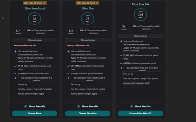

BT wholesale for my phone number, note the GFAST availability and Fibre on Demand.  I also know that the fibre exists right to the distribution cabinet outside my house (not lit I believe)
if I use EE availability checker but not my account.  As soon as I use my account the fibre max 100 goes away.
Every other ISP that offers GFAST services says I can have it because Openreach Wholesale says I can.
