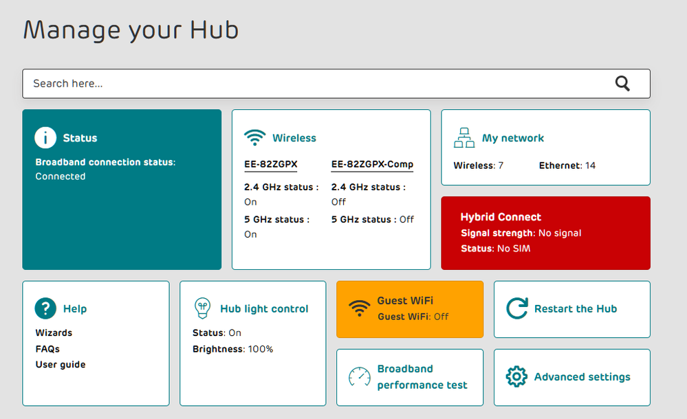

Screenshot 2025-06-23 082613.pngHi there, I just connected by hybrid connect box to my router, the centre ring is Aqua so is successfully paired with the router. However the signal bars are all red, When logging into the admin console it states that there is no signal and the status is No Sim. Help please

@marcusmartin Most off the solutions to that are take (out and reinsert) the supplied sim with the Hybrid unit, if not that then it's a check with EE CS that they have activated that SPECIAL sim supplied with the EE/BT Hybrid! Also that you are indeed in an area with a good 4g signal!
you were right, like a dummy the sim tray had come loose a little, I didnt
realise it even had a sim you could replace until i turned it over and
looked underneath, Thanks all working now
