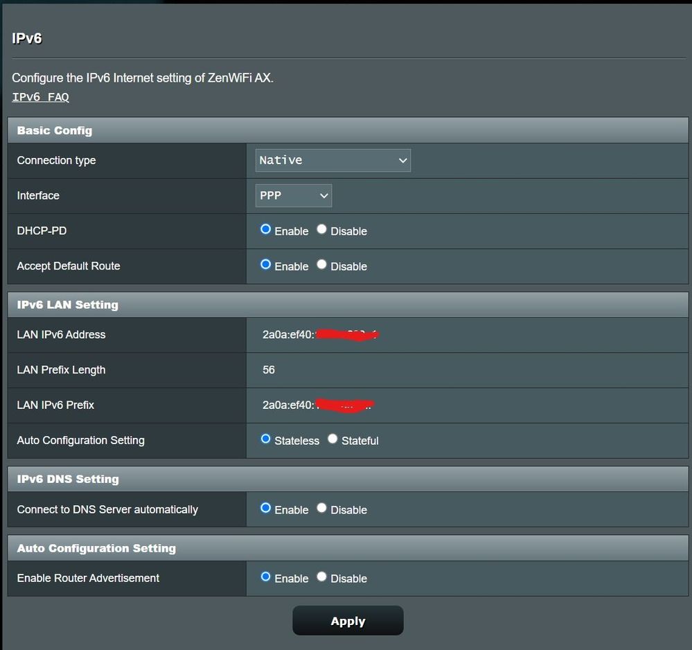

One thing that has been highlighted to me is that i dont currently have IPv6 configured which may (or may not) be causing my current issues, so the question i ask is there anything specific i need to do to enable IPv6 on non EE equipment? I have had a quick look at the router config and when i select the option to enable IPv6 there are a number of options when it comes to connection type or interface and i dont know where to beging with this, can anyone provide some advice for this?

@soupladel Asus iPv6 settings. Picture when cleared for general viewing. use www.whatismyipaddress.com to check what is getting through to your PC.
This should get iPv6 Working on your Asus..
