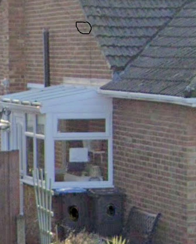

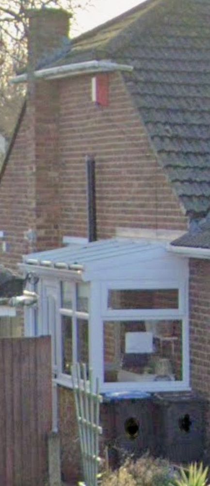

The issue I foresee with a fibre install is that, since the copper line was installed, a UPVC porch has been added, and flashing has been laid over the top. The anchor point on the property for the cable from the pole is no longer accessible from ground level using a ladder and I suspect a cherry picker would be required to get to it.

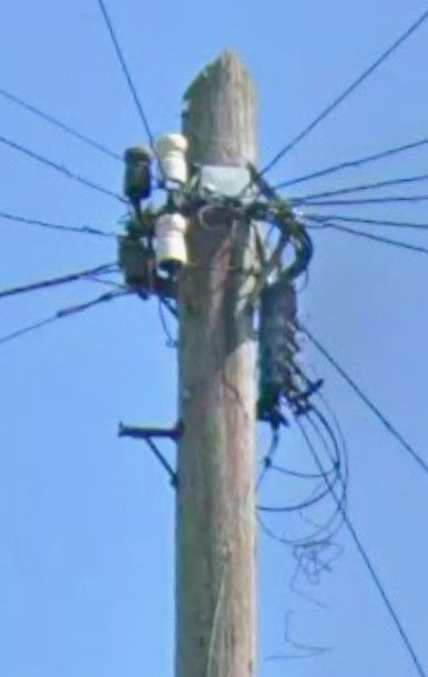

@smithm36312 ? is the full fibre connection also going to be pole fed, you can determine that if OR have mounted the CBT at the top off the pole it will also possibly indicate on the BTW as to what is going to be possible with the connection, use the address and postcode to check that.
BT Broadband
Thanks Jim.
Yes, I believe it will be pole fed. There's no underground ducting under the front garden, and there's no way they would have anyone dig a trench (which makes Virgin Media a no-go for them).
Pole top from latest Streetview image (Jul 2025):

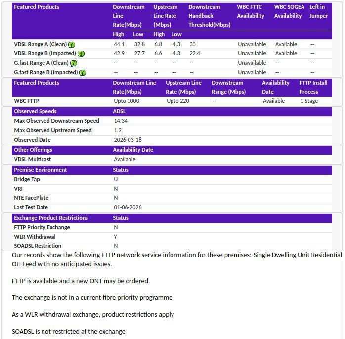

BTW Broadband Checker output below. SOGEA is available. If that's path they want to go down, will that require a phone conversation since the website only offers full fibre?

ISPs will not provide FTTC/SoGEA where FTTP is available.
Isn't there an alternative anchor point in easy reach of the pole?
I don't see your existing anchor point in your image.
Yes, you will have an OH feed for FTTP.
I've circled the anchor point below. Apologies for the low quality Streetview images, but I'm two hours away.
The wall in front of the porch could be an option to move the anchor point, albeit at a much lower level. That wall now has cladding on it, but I'm assuming that wouldn't be an issue....
If retaining the copper connection is a complete no (even though they are being forced to switch), I suspect the best course of action will be to arrange an install sooner rather than later and see what the engineer can do on the day.
Yes, I should order FF from EE & see what the OR eng. can come up with on the installation day.
After all the BTw Checker comes up with "no anticipated issues".
Thank you. Is there a mechanism for forewarning the engineer that the existing anchor point is not accessible by ladder, so they can consider whether additional equipment is likely to be needed ahead of time?
I can foresee a scenario where the anchor point is moved and the existing cable is left hanging down for them to deal with, which wouldn't go down well.
Not particularly. You could mention it if you order by phone or phone CS after you order online.
