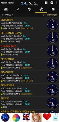

Also if you're on android download WiFi analyzer (open source) which is a great tool and check your WiFi is in compatibility mode and it's strength.

Cheers for that. I've downloaded the app but unsure what any of this means? My wifi is the EE TK8N7Q, but the one im trying to connect the doorbell to is the same as above but ends in COMP and is ONLY running on 2.4GHz via compatible WiFi

@Rocketfudge You have way more the one wi-fi name that is for sure, you need to connect to the comp on you phone and also try to latch the doorbell to that wi-fi also!
I've tried that too. I connect to the COMP network on my phone and the same with the doorbell through the app
