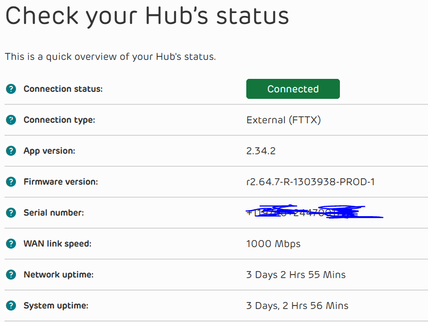

They have definitely fixed something although others are still complaining of drop-outs but we have gone 3+ days now with no downtime for the first time in quite a while
@bigsteve47 Thanks for posting up your Status screen, that makes it official now latest FW on the Pro version of the EE Router you have, and page to keep an eye on for the stability of the router, Network Uptime: will be the reset and can happen for any external reason, those are the hard ones to pin down, the Technical Events log is worth a look at from time to time to see what is connecting, dropping off, depending on how busy your network is etc, mine runs at about a page off events per day but that is on the EE Smarthub+ and FW currently from way back.👍👌

That page never showed any  downtime for me and also for the other users and I was still getting disconnected every single night. It stopped since I moved to a new router.  So that screenshot does not really prove anything, I had a 40 something days uptime on mine before the FW update. I just set up the EE smart hub back on and I am going to monitor my network for the next 3 nights while I am away. Might send the new router back to amazon if I don't need it
@Nonamesleft You are correct, you did not have any "external" reset's. I thought that i had seen posted that the FW update did not resolve the midnight update issue, but it was a posting by yourself but on the earlier before the rapid FW update change. As you know the script and what is happening correct to retry again, and as you know the only current true fix is to swap out the router for none EE type.
FW updates may be fixes for something's never logged so completely unknown to what, and sometimes fixes break others so it has to all start again.

When we had the resets at 3am that timer would reset on that page so it hasn't actually restarted at 3am in 4 days now. They have definitely fixed something but let's see what happens...
