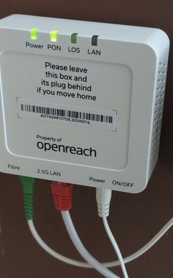

So, this is our first time with openreach. They installed first ever ONT in this flat. It looks like the first one from the link or at least very similar. It has different model number which is SDX601q. Can confirm LAN is flashing, PON is solid or flashing at random and power is on. LOS is always off. Aqua on the hub most of the time with long periods of blinking orange simultaneously with blinking PON on ONT.
Its this one:

@Dad66 The Adtran version is on the OR sin sheet but new and not fully there yet so i need to go look, DO think it is a 2.5Gb/s version although they have it currently marked up as a 1Gb/s so think OR has it wrong sheet wise......
I would do the starter for ten, switch them both off, leave 5 mins, after that time and this is important, ONT powered only, get it up to Power/Pon Solid, then leave another 5 mins.... After that and you are happy start the EE Pro hub up watching the ONT carefully as it all happens no blips on that ONT Power/Pon MUST stay solid....
Your posted picture needs to be approved for general viewing, so currently cannot be seen and not waiting for it to happen just so you are aware.... Jim

Och ok. So if this will take ages to approve I will just add a number on a ONT sticker "ADTN248107D6"
Lights : Power, PON, LOS, LAN

Picture cleared and you do have the correct ONT at least for your speed to be at the 1.8Gb/s that OR provide to get the 1.6Gb/s package to work. Also see that your Lan light is NOT lit, is the EE Pro hub off or not connected to the Pro wan connection?

Exactly, but its flashing quite often. This is older photo for an engineer. Todays morning PON was flashing, hub was flashing and my PC and mobile phones showed like "connected" without connection. We had Hub connected all the time to the WAN port with red cable. Engineer said during last visit that this red cable provoded cat5.e is not good enough so he said I must plug in my own cat6+ which I had two. One going from my PC to the hub and now from the hub to the ONT as well. That didnt changed anything. Wifi doesnt work and PC through ethernet cat6+ doesnt.
