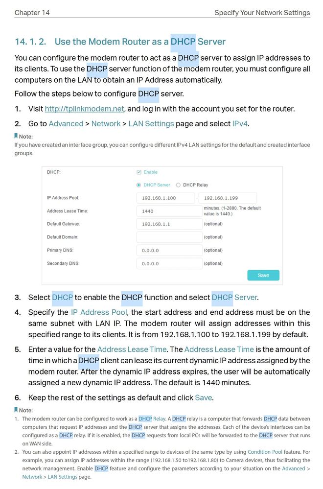

Hi Mustrum - thanks for the quick response. You'll know I'm a numpty at this when I say, "so how do I change the Archer WAN setting to DHCP or Access Point"...??! I've got the Router instructions PDF open - and there is a section called "Use the Modem Router as a DHCP Server" - am guessing that's it..??! 🤣

@Stalwart  yes that sounds the right bit.
It should change from the PPOE and your PN username and password so that it can just pich up the internet from the EE router .
@Mustrum - yep, that just got a whole new level of complexity!! 🤣. I understand absolutely nothing about this!!

@Stalwart   that is the wrong section, it is the WAN setting you need to change from PPOE to DHCP or Access Point depending on the options yu have.
EDIT, this link should help explain https://www.tp-link.com/uk/support/faq/1731/
