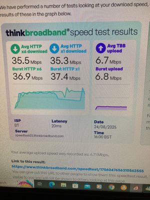

My best Mb/s is 38, fibre to box across road & copper to house. My neighbor has same but gets 50Mb/s. I challenged this & he said he has run speed test many times. How can this be?

Which EE BB plan are you on? It's quite on the cards you are on a EE Fibre plan capped at 40 Meg & he is on the EE Fibre Plus plan which can go up to 80 Mrg.

@Agileant1 The image is re-posted is there something further you are looking for!
Wanted to know if I have EE Fibre or EE Fibre Plus as I cannot find either on my details
@Agileant1 Look on a bill, it will say what you have from EE!
When you answer points 1 & 3 of my query I'll be able to tell.
Previously on Legacy EE Broadband there were Fibre plans and Fibre Plus plans.
On New EE there are Fibre 36, Fibre 50 and Fibre 74 tiers on FTTC. If you have a BT Smart Hub 2 (after migrating from BT), an EE Smart Hub (2023) or an EE Smart Hub Plus you will be on one of these plans. The hubs are shown below:
https://ee.co.uk/help/broadband/manage-use/manage-your-ee-hub
It looks as though you would be on a New EE Fibre 36 plan based on your speedtest, but none of us know what your line is capable of or any of your package details. Its also possible you could have been sold a Fibre 50 plan but with adjusted Average Speed estimations and Speed Guarantees based on your line.
If you can follow the 3rd point in @XRaySpeX's reply to check the BT Wholesale Checker this will inform your maximum line speed.
Your initial email order confirmation from EE for your broadband package usually shows your estimated speeds etc and the name of your package.
