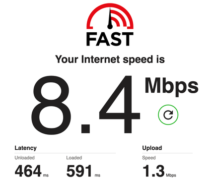

OK, well that didn't last long. Broadband speed back down to 8 Mbps again. 🙄
@TheCatweasel Is that down or up, post your speed test! Your figures are a 50/8Mb/s split speed sync, ie 50Mb/s down with 8Mb/s up. Speed check's are not 100% but do either www.fast.com or either the others!
https://www.thinkbroadband.com/speedtest
https://speed.cloudflare.com/
@TheCatweasel Have not seen latency like that for years, half a second 464ms even before you start, so is that a wireless wi-fi connection, or even worse if it was wired to Ethernet!

Thanks for your replies, and sorry for my delay in responding.
I took the nuclear option and did a factory reset on the router, removed all connected devices (speakers, NAS drive etc) and then added each one by one.
I now think the cause is my Amazon Echo Spot. If I remove this device when the speeds drop then that fixes things. A factory reset on this only works for a few hours until speeds drop again. Removing this completely from the network and speeds work as they should.
I'm not sure what the exact cause is yet but at least I think I know the culprit.
