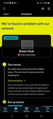

Tried to connect to my app and hub to see. Started an firmware update but not sure if finished because connection was there for like half a minute... but i managed to click the hub again to see this. No my attachment will need to be approved....to .make it faster I will just type info here
"Poor connection" "Your hub could be in sync with exchange or cabinet, but not connecting to the gateway. If there is no point to point protocol session its likely to be a problem with our network"

Edit:- App posted picture should NOT be off a Smart Hub, but that off an EE Pro Hub, hopefully that corrects itself but not sure what an app would show correctly now?

04-10-2026 03:05 PM - edited 04-10-2026 03:07 PM
I noticed that. In my broadband section pro hub is shown but in any other place its that black hub which I dont have. I had it all the time like that in the app. I think because I have no connection I have to use my mobile data. When I had a chance to get to the app through wifi then it shows proper hub 7
