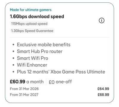

£60.99 a month plus CPI rise for 1.6Gbps for 2 years seem too good to.not take considering BT want me to renew for £87 just for 900Mbps
Attached picture is the offer that comes up
