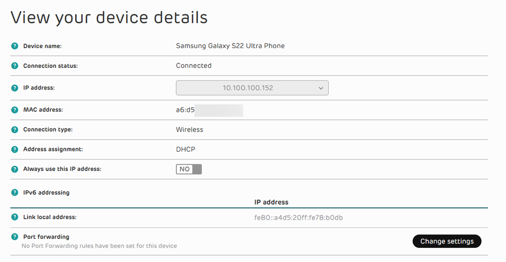

@XRaySpeX  Crikey!
When I connect my S22 Ultra to the guest wifi  it gets a 10.100.100.0/24 address.  However, I assume because it uses a randomised MAC address, I don't think it can be associated with any previous IP to the 192.168.1.0/23 subnet.
GuestWifiConnection.pngFWIW, I cannot ping from my PC to the S22 nor vice versa when connected to the guest wifi.
If I set my phone's wifi connections to both the guest wifi and main wifi to have my phone's MAC address instead of random and  then connecting to the main wifi first, the guest wifi does assign the same local link address to both connections but the 10.100.100.0/24 wifi connection is definitely still isolated from the main as I cannot ping between my PC and the phone when on Guest Wifi.
Perhaps there are some firewall rules you  have lurking in the background somewhere that allows you to ping between subnets?
