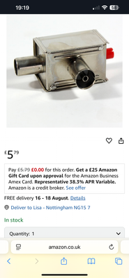

The EE box is susceptible to strong aerial signals, the tuners are poor to be honest. The suggested solution is to buy an adjustable attenuator and limit the aerial signal strength to 90%.
To switch to internet mode you need to go into maintenance mode on the EE box by following the relevant options here.

You could plug the aerial straight into your TV, if there's no pixelating then the problem is as I've suggested. If you don't want to mess about with an attenuator then you could leave the aerial connected to the TV and switch the EE Box to internet mode. That way you can record what's available on the box and watch the additional channels such as Drama live on the TV.

Andy. What can I say. I’ve bought a £5.79 attenuator (which I’ve never heard of or knew existed) until your post. Plugged it in and not even turned the red dial and it’s solved my problem! You are amazing! Thanks, really appreciate it
Thanks Zulu, see my reply to Andy above. All sorted 😄
