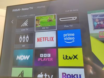

I am intermittently getting the above error code including a couple or minutes ago, when putting my EE Pro box hdmi source back on after watching itv3 in IP mode.
After it asks me to call EE, I press ok and it then works.
Can this please be investigated?
Thanks

IPC6017 occurs when the content protection rules fail to apply.  In your case, it'll be because you've switched to an alternative HDMI source, causing the HDCP session to be terminated.  When you switch back, the channel is trying to resume, but the TV is a little slow to resume the protection.
Are you switching between HDMI sources on the TV?  Or using an external switcher? (e.g. an amp)
@DarrenDev, it's a Roku tv so there is no source button or external switcher as such. I just choose the hdmi input from the main screen.
Is this going to be a continuing issue with the Pro TV box and my TV? Should I switch to the apple TV product to avoid this error?

From what I can tell @Weerab2024 it's happened 3 times for you.  Each time, you were in an app when you switched to a different input (we're not allowed to know which app).  When you switch back to the TV Box input it causes the app to terminate, which then attempts to start the channel again - but your TV hasn't negotiated settings again yet.  When you leave the TV Box Pro consuming a TV channel, it switches back without error.
Do you know which app you were in?
@DarrenDev I think it was the itvx app within the pro box.
I didn't actually go to a different source on my Roku tv so not sure what is happening
