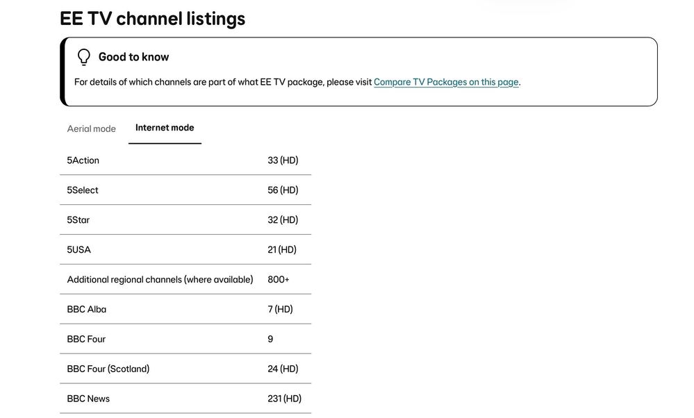

Hi quick question, have an EE box Pro setup in internet mode with the aerial connected, but missing some channel 5 Freeview channels.. Specifically 32 and 33. I’ve run through the EE checklist, unhidden all channels, retuned and checked connections. Checked aerial signal quality and strength on ch001 and both at 100%. Am I missing something obvious? The Freeview website says they are available at my postcode. Thanks in advance. Warren.

EE website says channels 32 and 33 available on internet mode.
