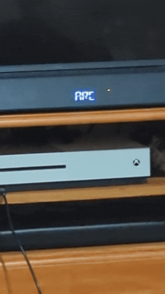

Short video of the soundbar 'stuck'
Just a short video showing the soundbar not being able to turn off
