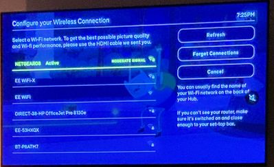

@Filberg
Yes and yes. Not a sniff of WPS, and six to choose from without it:-
