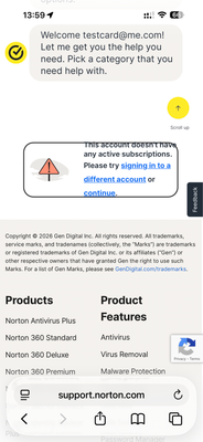

Hi, this is what I get from Norton.  I subscribe through EE so would’ve thought they hold responsiblity?

yes on all counts... and still can't get into the VPN on the Mac. It appears an issue with EE, not Norton. It's disappointing that it hasn't been resoled on an otherwise great app.
