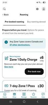

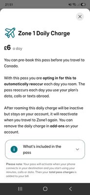

Hey, thanks for the reply. These are screen shots from my ee app... hope that helps explain my confusion about the messaging being given out about when you are charged! Thanks

Hiya, can't provide a link from my app? And no i'm a regular daily customer on a monthly sim only contract not business. I can't believe it is this hard and expensive to use a phone abroad if you need when other networks allow you to add add ons that only activate when you actually use your plan! Thanks

OP has provided a screenshot from the app... unless you know differently (and if so, please explain how) you can't provide URL links from apps.
I'm on a personal account and also see the same as the OP.

I can appreciate the confusion and wanting to make sure that you aren't charged @Clomo.
The key part I'm looking at is from the description in your screenshot from the app above, which says "The pass reoccurs each day you use your plan's data, calls or texts abroad" so if you aren't using the allowances there would be no charge.
