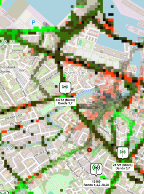

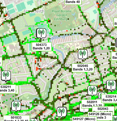

Leith and Stockbridge are busy areas and ideally EE should look at installing new masts in these areas. Even looking at cellmapper, there is a lot of red indicating poor coverage. Stockbridge below:

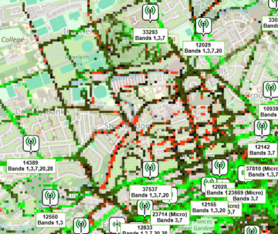

O2 and Vodafone have two masts in this area:

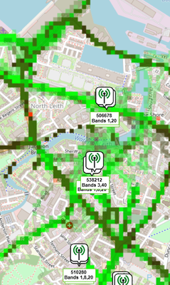

The same with Leith:
Vs O2 with two masts in this area:
