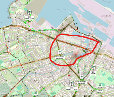

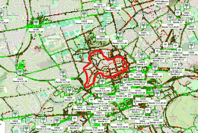

Leith and Stockbridge are busy areas and ideally EE should look at installing new masts in these areas. Even looking at cellmapper, there is a lot of red indicating poor coverage. Stockbridge below:
O2 and Vodafone have two masts in this area:
The same with Leith:
Vs O2 with two masts in this area:
20-06-2026 11:26 PM

In Leith, this whole area has a similar issue. 4G band 20 outdoors (n28 available but won't connect automatically), no data whatsoever. There is a new mast in Newhaven, but it does not reach the Shore or central Leith.
