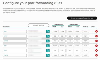

This is definitely not true unless I'm misinterpreting your problem. Case in point below, taken from a Smart Hub Plus: -

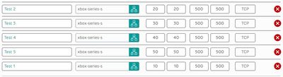

I have also managed to successfully configure five additional port forwarding rules for different external ports that all translate to the same internal port/device: -

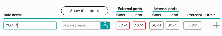

That said, I have just tried to create the rules from your latest post. I got as far as the third rule and encountered the issue I think you're describing when trying to enter the fourth: -
This doesn't appear to be anything to do with an upper limit on rules, rather a validation error with the external port entry as indicated by the red borders you can see above.

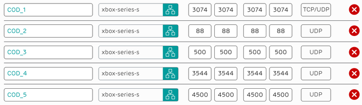

I then noticed that you have two separate rules listed in your post for port 3074, one TCP and one UDP. Could this be your problem? You would need to enter these port assignments as a single combined TCP/UDP rule as seen below (which works fine for me): -
