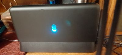

Which model of Hub is it you're using too?
Feel free to share a photo if you're not sure.
