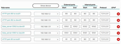

The answer appears to be no - I believe I have ports 80 and 81 both set to forward to port 80 on the same system:
When accessed internally (from the LAN side of the Smart Hub), port 81 goes to the 192.168.1.2 device (as hoped) but port 80 goes to the Smart Hub's own Hub Manager page.
When accessed externally (i.e. from something not on the internal network), port 81 goes to the 192.168.1.2 device (as hoped) and port 80 times out.

These are my port forwarding rules now:
From a device outside the LAN (I have tested this myself using a 4G LTE router containing a Three SIM (and so compeletely separate to my EE broadband) and I have also had a friend test it who lives on the opposite side of the country) http://home.domain.tld:81/ correctly goes to the web server at  192.168.1.2, http://home.domain.tld:82/ correctly goes to the webserver at 192.168.1.31, and the non-standqrd ports 9361 and 9362 correctly go to the relevant services on the servers at 192.168.1.31 and 192.168.1.33 respectively. However, http://home.domain.tld/ or http://home.domain.tld:80/ both time out.

It is the Internal ports that are the ones being Port Forwarded. These are the ports on which your devices/servers are listening. The External ports are like aliases you hand out to remote users to address your internal devices/servers. In fact most peeps config Port Forwarding with External range = Internal Range.
In your 3 cases of Port Forwarding to Internal port 80 from outside, the 2 with the External "alias" 81 & 82 will always work. However the 1 with the External "alias" 80 can't work as it gets directed immediately to the router's HTTP GUI before it ever hits the Port Forwarding rules. This in turn refuses to accept access from outside & so times out. It was this I was thinking of in my 1st response.
When you address these External ports from inside your LAN. External ports 81 & 82 will still work but 80 will again access the HTTP GUI but this time will be accepted as it's coming internally.
So the upshot is if you want to Port Forward port 80 of a local device/server all you've got to do is give it an External "alias" so it doesn't get mixed up with the router's HTTP GUI.

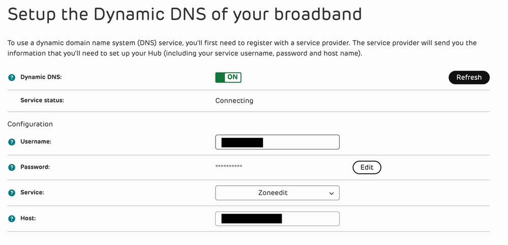

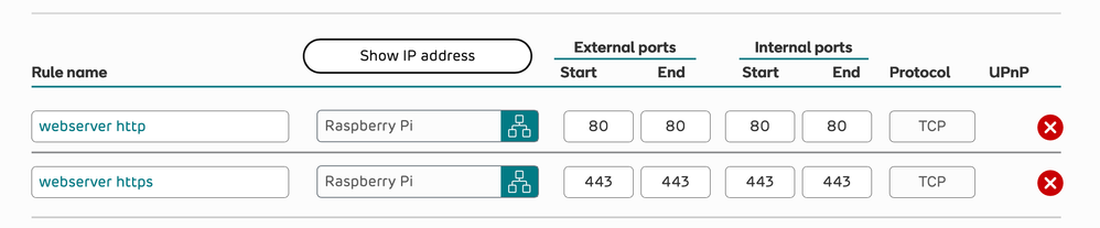

EE Smart Hub Plus: SH31B
Firmware: r3.8.11-R-1414606-PROD-83002
Port Forwarding Screenshot
Dynamic DNS Screenshot
The images will likely have to be approved before they can be viewed.
One of the websites being hosted is buonacorsi.com which is a single page for access to a family's grandma's life story monologue. So you will be able to see that this works. There is a redirect within the webserver itself from port 80 to 443, so both ports are open but if you go to http://buonacorsi.com it will go to the site using port 80 first before redirecting. Port 80 is open so that the SSL certificate can be renewed automatically - part of the certbot requirements.
As you can see, the forwarding is pretty standard. The Raspberry Pi has a local private IP Address. The A record at the domain name registry at Zoneedit is a DYN one as the public IP Addresses supplied are always dynamic so you will need to use this type of service in order to use a domain name. Just an A record pointed at your IP Address will only work if your router hasn't rebooted and been provided with a new public IP. Hence the screenshot for the Dynamic DNS page.
Do not believe any personal information is left on these and as the website is public, I see no problem in that - it's just not relevant to anyone outside of that family.
Assuming the firmware level is the same I doubt very much the model of router will make any difference as it would be the same software, and the hardware would be near identical - and this is a 'software' issue you believe you are having.

Here is a thought - a thought only, but the theory fits.
Assuming your web server you are trying to access also has a http to https redirect which you haven't accounted for:
1 - You do not have Port 443 open in the Port Forwarding, so if it is successfully accessing Port 80 from outside but then attempting a redirect to port 443 it will not get anywhere and would result in what you are seeing.
2 - Trying the above internally would land you at the router page on https as it would successfully reach port 80, then attempt a redirect to the 'external public IP' but on port 443 - as the router itself knows the destination of that external public IP — itself — then it would simply process the request on port 443 on the router itself, showing you the Hub Manager page - you should be able to check this in the browser to see if it shows https or not.
Again, as I said, an idea based on a 80 - 443 redirect you had forgotten about. If there isn't one, then the theory dies.
