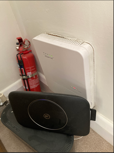

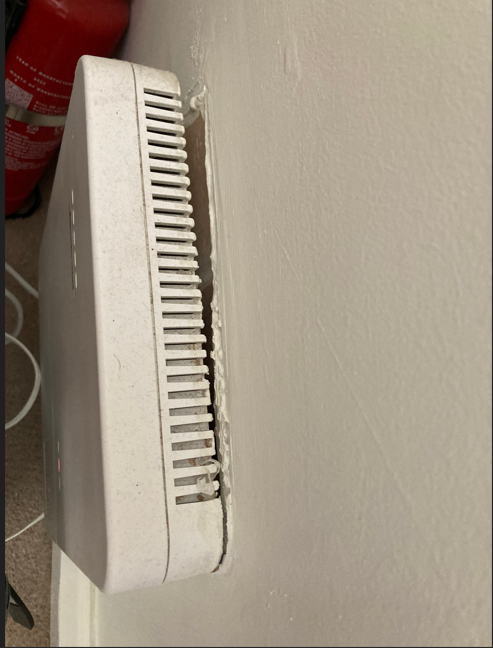

We were fitted a router which according to people that have seen it say that it is not something they have seen fitted before. It appears much too big for the job that it does and has become detached from the wall. The door at the bottom won't stay closed exposes the wires and has to be wedged closed. What can be done about this please as it looks a bit dangerous.

That white box is not a router but an ONT modem that brings the BB into your home for you to connect the (BT Smart Hub 2) router (that's the black thing). The ONT was fitted by an OR eng., seemingly faultily, when your BB was installed. You need to call CS the report a badly installed ONT.

@Dafrost1187 That ONT box was fitted quite some time. The ridge of paint around it gives that away it’s built up around the edge. It wasn’t like that when it got installed as there’s no paint behind it and it’s been painted around
You could ask EE to send out an engineer, but this will be at your cost to have it reattached. or just refit it yourself just be very careful if you do.

The reason it's so large is because it's one of the older ones. It is actually an outer case housing an ONT (Optical Network Terminal) and a BBU (battery backup unit). The modern ones don't come with a battery backup and so don't have that large outer case. (And the red light means the battery has had it, by the way).
