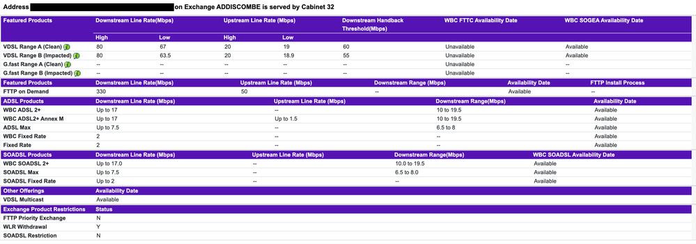

Thanks for your reply, the wholesale checker has this information:
CodeLook estimates my distance to the cabinet between 600-700m. I estimate the straight line distance is less than 200m (I can walk to it in 2 minutes) so I would expect I should easily exceed 36 mbit.
Yes, you should get at least 67 Meg there & probably 80 Meg.
