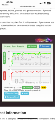

2. Try a speedtest, preferably wired using an Ethernet cable supplied with the router, here http://www.thinkbroadband.com/speedtest.html . Click on the "Results Page" button at the bottom of the graph you first see and then copy to here just the "Link to this result:" link that you see below the next main graph.

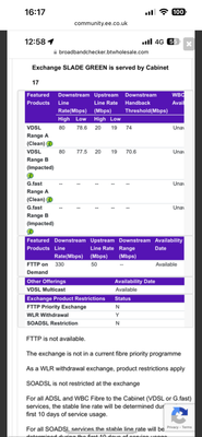

3. What does BT Wholesale Broadband Availability Checker estimate for your phone number? Post just the whole table and the line above it, blanking out your phone number. If it doesn't recognise your phone number or you don't have one, use the Address Checker, not the Postcode Checker.

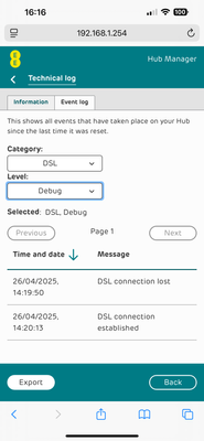

I have no idea on how to access the first point.
I have screen shots of the 2nd and the 3rd point it won’t load.

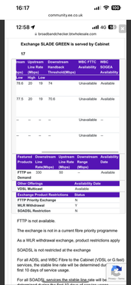

I’ve used it before and it said my buildings max speed is 67mbps. I do live in a block of flats if that means anything.

@qusvz :
  1. Login to your EE Smart Hub/Router at http://192.168.1.254 with the admin password on the bottom of the slider label on the back of the router.
  2. That's a nice flat speedtest. It just doesn't go as fast as it might. Looks as if Fibre 67 would be of no further use to you.
  3. How far the BTw Checker get? If you don't have a landline no. choose the Addy Checker from the 3-bar gate menu at top.
Okay, I had to use screenshots from a month back of the bt address checker.
but here-
XRaySpeX
EE Community Star
EE Community Star
If last month's BTw Checker results are still valid that line's good for 80 Meg. Thereby Fibre 67 would be a benefit.

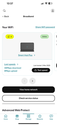

However the router is only sync'ing at 39 Meg (for 10 days). I just don't like the discrepancy with the EE app speedtest of 48 Meg. The router must know the true state of affairs.
