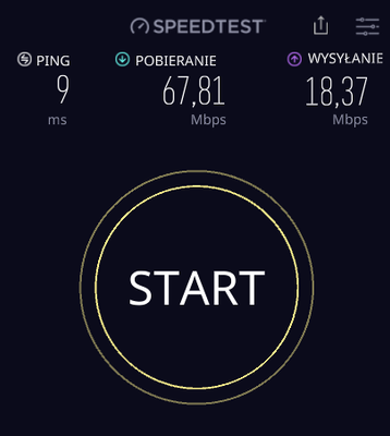

1. I am using supplied router
2.No idea what plan it is
3.Below its current speeds on wifi
4.No i can't used wire connection

@VisHD Looks like you may be having an upload issue with the Line, you may have to get the owner to do a HELP to 66033 for a line test to see if anything gets thrown up to EE, but upload's they care not about so nothing may happen if the download speed hangs in there. You should also run the speed test at various times when issue is not as bad and see if you do get the 50/10Mb/s ever reported back rather than your 50/4 currently. WiFi checking is NOT the way to be testing...
