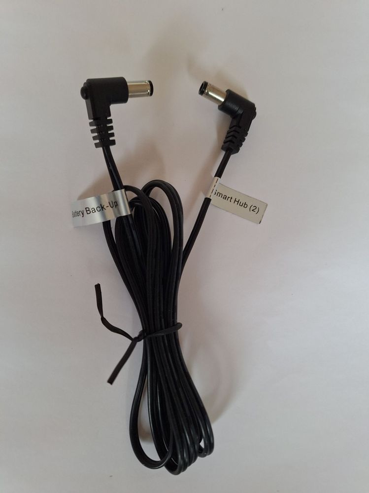

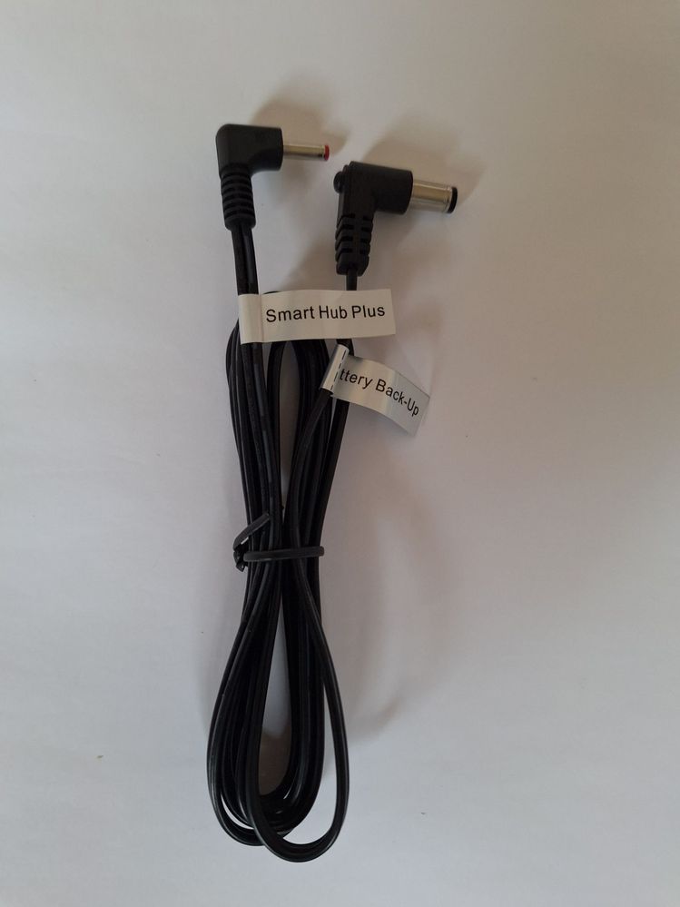

@Denzel99 This is the closest i can see, i have a set of CyberPower cables one was on the ONT and the Other on the EE Smart Hub6+, now the cable marked has Smart Hub (2) on it but was used to connect the ONT up, so one assumes the ONT/SH(2) are as it's the exact same plug for the ONT. The CyberPower plugs are right angled plugs but don't see a cable on Amazon. The one shown on the BT Forum is a NO NO, it's for the new BBU....
If the user has an ONT, get him to try the power connector from that in his BT Smart Hub 2, do not have access to one so cannot say. Cable is 1.5M long CyberPower supplied can take a picture if you need.

The Two pictures for you,
BBU / SH2 markedBBU /Smart Hub Plus marked

@JimM11   I can see the pictures now.  That cable in the top picture looks like the the right thing.  Where did you get that from?
@Denzel99 I fitted two units for my sister on the EE Hub/ONT, she is wheelchair bound Vulnerable status, with the CyberPower version DTB24U12V-BT3 you get Two cables with each BBU, as one set did everything then extra was left over, they are 5.5/2.1mm both sides for the SH2 marked version but was used to the ONT so i assume the same cable for both, the other is a 5.5/2.1mm to a 3.5/1.35mm as used to connect up a EE Smart Hub 6+ as it is now known new name...
