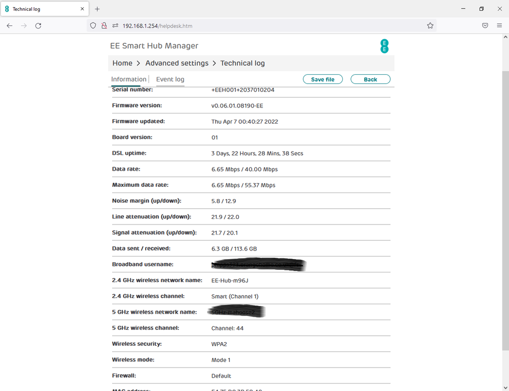

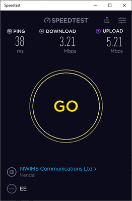

Started to work - noticed that things were a bit slow over the vpn. Went to my own pc and connected via a wire. Run speed test
WEnt to the router and got the stats
The router says 40mbps but speed test says 3mbps. I am inclined to go believe the speed test as the behaviour of my devices (both work and non-work) say that I have a congested link somewhere. The congestion is due to my link running a lot slower than the 40mbps advertised on the broadband router. For absence of doubt the speed test was not run over a vpn but on my personal pc connected by wire.

The router stats & the speedtest are measuring 2 diff things. The router shows your raw BB sync speed which EE is supplying you with. The speedtest is measuring your resultant d/load speed over the Net after network overheads are taken into account & this can be variable & not under EE's control.
Is the QLT silent?

@ferretisblind the symptoms you describe could be down to congestion. If it was happening regularly in the evening then I would be asking EE to look at the cabinet/exchange equipment.
But as it is more random it could be with your equipment - is there anything else connected when you notice this - devices automatically updating, backup to idrive/onedrive or other cloud based storage? Even the VPN getting congested.
Rather than rebooting the router next time it happens, turn connected devices off - turn wireless off will quickly help you work out if it is a wireless device. Wired devices one at a time, and if you can use task manager to check apps on your pb/laptop and close down any using bandwidth.
