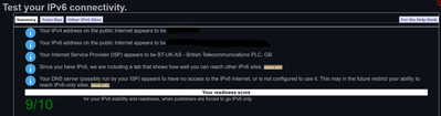

@blackops786187 Check were the FW is at on your hub, the versions are all up in your post earlier entry. That will let you know were it is at, just incase update is messing with your assigned wan IP's.
Test your IPv6.

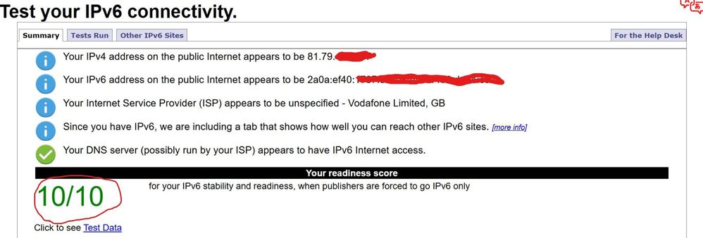

@blackops786187 Captured test....
IpV6 when working correct.IpV6 when working correct.
