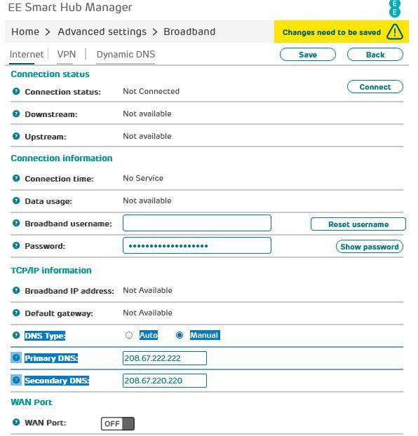

@bobpullen wrote:
What does the area of the hub manager look like where you can assign custom DNS? What menus do you navigate through to get to it? Just trying to reinforce my belief that the DNS is supposed to be dished out by the DHCP server.

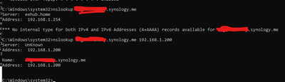

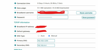

Yeah releasing the DNS and renewing it had no effect.
Primary DNS is pointing to my local DNS ( now .200 ) I've tried everything in the secondary ( it doesn't like being blank ) currently set to an unknown ip address, have tried both pointing to my local DNS, but still nothing.
Looking at the clients, they all have the smart hub as their DNS
Doing an nslookup, its looking up using the Smarthub DNS, not my custom DNS, which is working

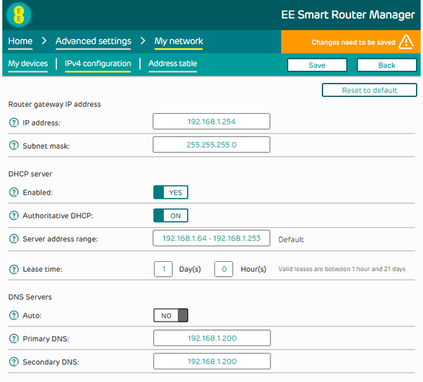

Thanks @XRaySpeX - that addresses that aspect then.
Differs to the Smart Router that assigns custom DNS via DHCP, rather than assigning to the WAN connection: -

So it does look like the EE Smart Hub is ignoring the DNS server settings

@mattius001 - so, if the Smart Hub is only capable of attaching custom DNS to the PPP interface, and that's still not routing the internal traffic correctly for you, then there could be an alternative solution.
I don't know what model of Synology NAS you are using, but does it have the ability to act as a DHCP server as this suggests?
If it does, then you could disable DHCP on the Smart Hub (assuming it allows this), enable DHCP on your NAS (assuming it stays powered up all the time), and then configure the DHCP parameters on the NAS to issue itself as the primary/secondary DNS server addresses as part of the DHCP lease.
It doesn't really! They are just configured on the same page (everything to do with IPv4) but are not otherwise connected.

@XRaySpeX wrote:
@XRaySpeX  - are you sure about that?
The BT Smarthub 2 (and the Plusnet Hub Two for that matter) have a very similar interface, and for both of those, the custom DNS will be issued as part of the DHCP lease. In fact, when you have things configured this way, you can navigate to the Broadband Status when connected and see that the PPP interface is still assigned the DNS it has obtained from the PPP session. This is depspite all connected DHCP clients using the custom DNS that has been specified.
