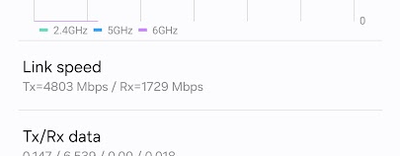

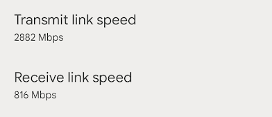

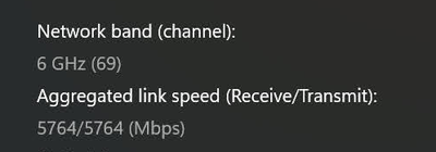

@Bluenose_Dave - these are all Wi-Fi 7 devices, rather than Wi-Fi 6E and practically next to my extender. The transmit speeds are close to/at max, but the receive speed isn't 🤔
My Wi-Fi environment is pretty busy so unsure how that may be contributing to things.
Google Pixel 9 Pro XL (this will be using 160MHz channel width): -
Samsung S24 Ultra (this will be using 320MHz channel width): -
Windows Surface laptop (this will probably be using 320MHz channel width, although I don't trust it's a real-time measure as Windows seems to always show absolute max link speed, even when a moderate distance from the extender): -

@Bluenose_Dave - so to be clear, is your problem that the 6GHz receive link drops to 816mbps, like seen in the first of my images? And that it's unique to the extender and doesn't happen with the same device next to the hub?
19-05-2025 03:27 PM - edited 19-05-2025 03:28 PM
the 2268mbps is right next to router and the 816mbps is one of the extenders but all the extenders have the issues
