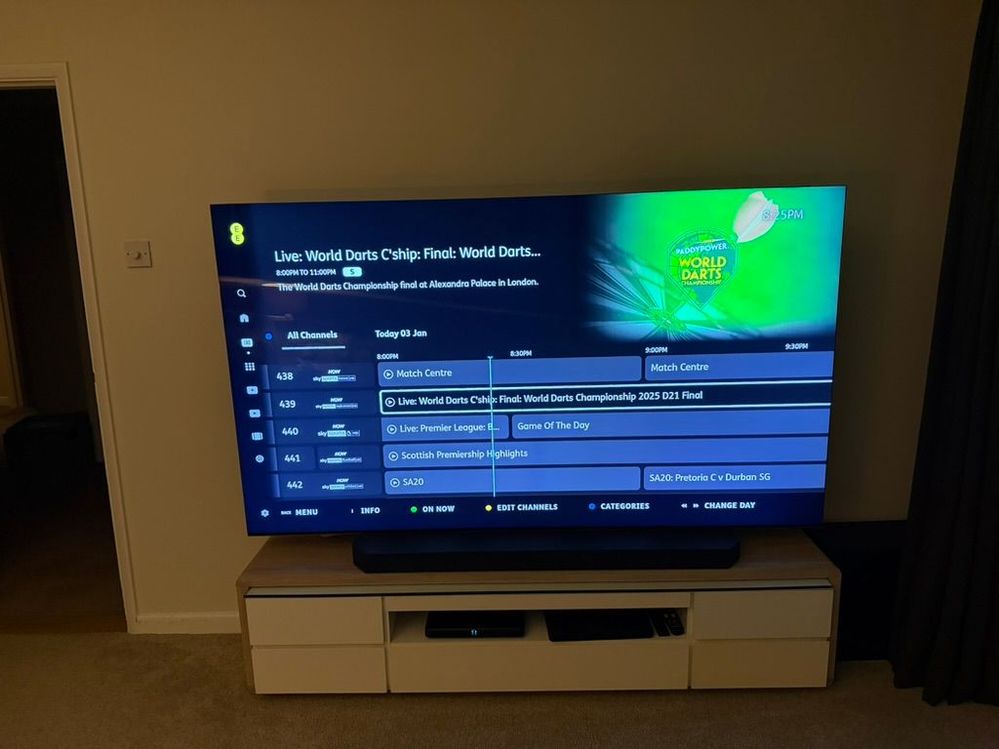

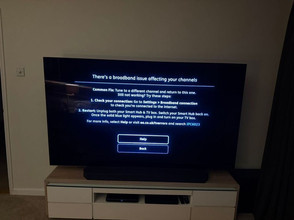

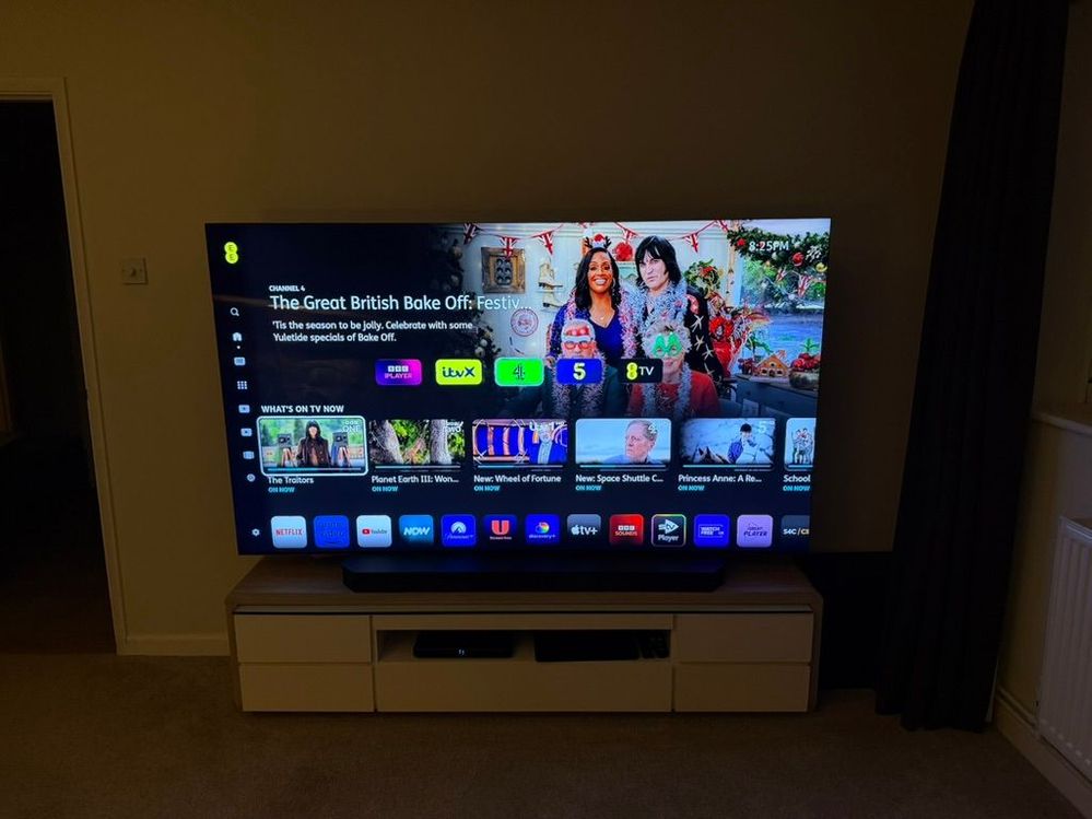

I am unable to connect the Ethernet cable to the main router but I have one of the ORBI WIFI Extenders next to my TV Pro Box and I have connected this via Ethernet. I have confirmation in the settings that I am connected to the internet, I can watch all the apps on the TV box i.e. Netflix, NOW, etc.. can see the TV Guide and the live stations but again I am getting the same failure message I took on Saturday in the pictures below. Thanks.

Your Orbi router isn't correctly passing the multicast traffic that the TV Box requires to watch TV channels.  Various Orbi devices have been discussed on the BT and EE forums previously, and I'm not aware of anyone successfully getting it to work.
You'd need to speak to Orbi directly and ask for their assistance in getting multicast IP TV working through it.

The TV Box Pro and TV Box Edge use multicast to deliver the TV channels.  This requires that all networking components support multicast traffic, and it appears that Orbi doesn't (despite it being a standard networking feature).
