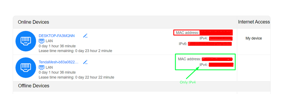

It was an issue with IPv4 connectivity. Deduced this by looking at devices and viewing what could and couldn't connect to the internet. only the Tenda mesh router didn't have an IPv6. That led me to research posts on EE and the CPE pro not working with IPv4, which led to a solution!
The mesh router only communicated via IPv4, and had no Ipv6. This wouldn't allow it to connect to the internet with EE's default APN detected by the Huawei H112-370.
Changing the APN to prefer Ipv4 instead of Ipv4 & 6 solved the problem. (this post had the solution 'APN Ipv4 EE with CPE pro')

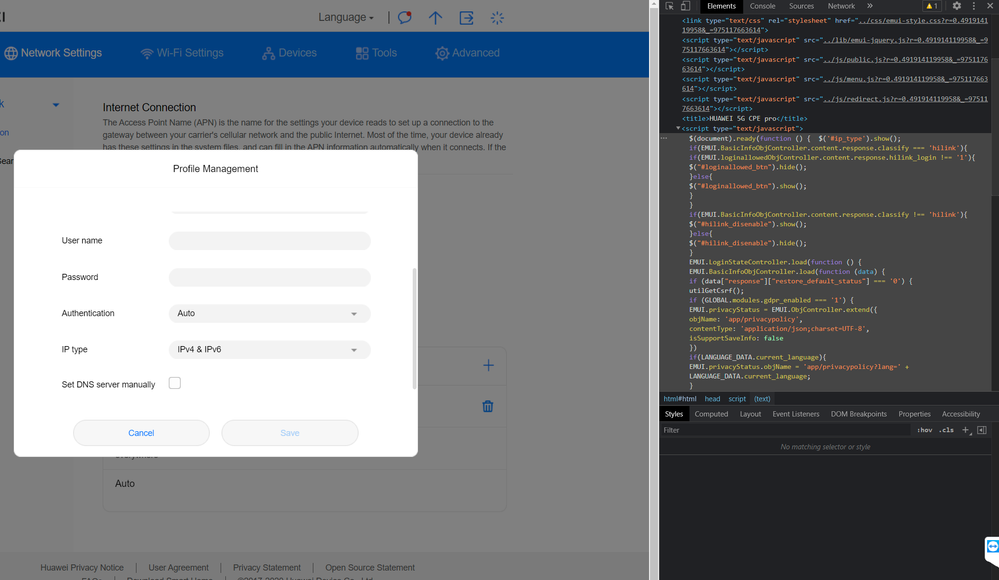

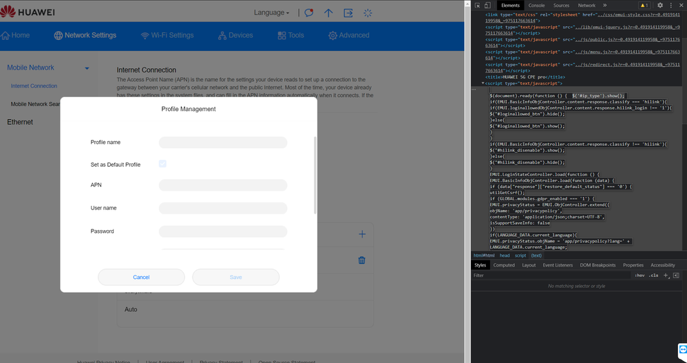

However there was another issue, Huawei had hidden the crucial option to change this via a firmware update. They had only hidden the option not removed it though. Using a this command line in developer options in chrome allowed me show the hidden settings, again sourced from the post above.
See pics:
Normal menu of my Huawei H112-370 on firmware 10.0.05, with code highlighted and inputted into elements.
Menu after inputted code with necessary options (have to close the menu and reopen to initiate a new line of code)

Code to input into elements when profile menu open to reveal hidden options posted by tmrbnsn
$('#ip_type').show();
See pics:
