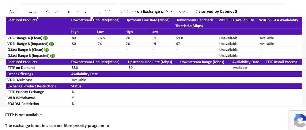

If you have EE BB + DV then the BB is not dependant on your landline no. You won't have full FTTC but a variant known as SoGEA where the Fibre BB comes into the home on a copper landline that has no voice service or no. The landline is DV with its own no. Also the landline contract is just a separate monthly add-on which you can cancel at at any time w/out affecting your BB.
Therefore you can cancel your landline at any time by porting it to a VoIP provider.
What does BT Wholesale Broadband Availability Checker estimate for your phone number? Post just the whole table and the line above it, blanking out your phone number. If it doesn't recognise your phone number or you don't have one, use the Address Checker, not the Postcode Checker.

23-09-2026 05:57 PM
Thanks. I had to use the address checker as it didn't recognise the phone number. Attached is a screenshot of the Table.
