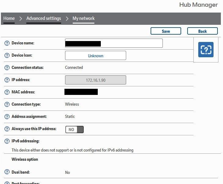

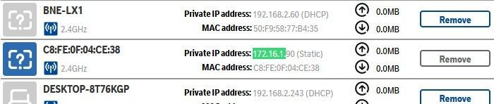

Hi,
The DHCP of my EE hub is configured to use the IP range 192.168.2.x to lease IPs to devices connected to WIFI. This works for like 80% of the time but there are situations where it starts to lease IPs from the range 17.16.1.x??? Does anyone know what's going on here? What  makes it worse is that those devices wouldn't be able to access the internet and I cannot change the assigned IP or remove them from with in the hub.

@akamal What EE Router do you have? are you seeing the erroneous IP range displayed in the web interface, or is it showing only on the app, when you click on the IP web interface, it does not allow you to correct the IP, you will not be allowed to change to anything that the router has previously assigned and now hidden away from view. Picture will take time to be released for viewing.

That image would be approved if the MACs were obscured.
!72.16.0.0/16 is 1 of the possible Server Addy Ranges of the SH+'s DHCP but it is more likely that you have set up that device with that static IP with "Always use this IP address:" in the router or the device itself is setting its own static IP.
Click on that device in that My Network list. When it opens up does say "Always use this IP address:" = YES?
Perhaps you once used that Server Addy Range but since changed it & forget to remove a Static IP on it.
Thank you imM11 and XRaySpeX for replying. I got the router a few months back when I renewed my contract from BT to EE. I’m using the web interface of the router to check whenever a device joins my WIFI but fails to connect to the internet. That’s when I started to see that erroneous IP range.
for the device in question, it does say "Always use this IP address:" = NO
All devices connected to my WIFI are configured to use DHCP. No static IP assignment. This issue is not specific to a particular device. I see it on Windows, Linux, Android and IOS.

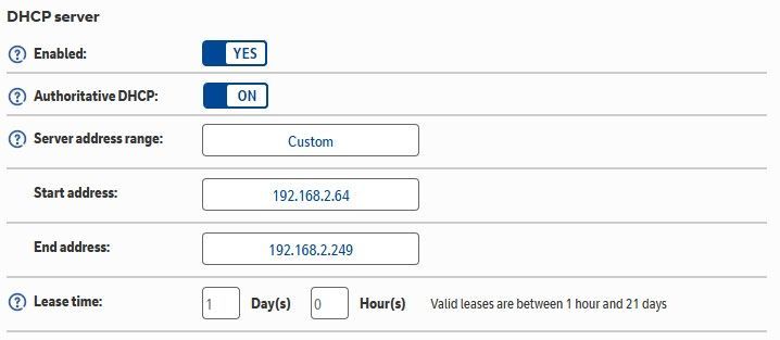

I have factory reset the router multiple times and my latest attempt is to use a custom IP range of 192.168.2.x rather than the default 192.168.1.x.

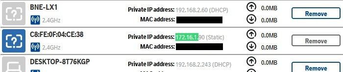

I’m re-attaching the images with MACs obscured.

@akamal It would also be good if you can post some text with regards to the current FW that the router is on. Status page or technical log will show you the information. Images again when approved will be viewed. You only have one router on the system the EE, not doing anything else like 2nd router with double nat and it's dhcp on by mistake?

The device in question must be setting its own fixed IP. What is it? Have a look at its settings.
